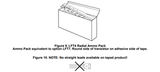

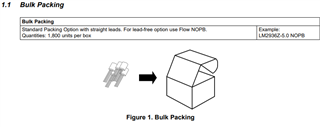

1. what's the pin variance between LM35DZ/NOPB and LM35DZ/LFT4, Both MPN pin are straight or one of them pin is bend
2. you can contact me by E-mail, then I will write you E-mail and show pictures to show our requirement more clearly
Hi Haiyong,
The difference here is the packing options, which does impact lead option, as shown in this note from the datasheet:
NOPB = bulk pack (straight leads), LFT4 = ammo pack (formed leads)
Please see https://www.ti.com/lit/an/snoa072a/snoa072a.pdf for more info.
