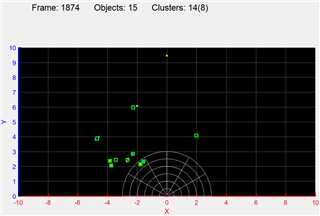

2) Why does the number shown by Clusters differ from the box marked on the coordinates in the TI obstacle Detection AOP GUI?
Clusters displays 14(8), but only 10 identification boxes are counted at coordinates. Why is this? Is it related to ods_aop_config.cfg?
Could you help check this case? Thanks.
Cherry
    For Question 1, yes, your understanding is correct. we also recommend you use the matlab gui to understand how the QFormat is used to compute the final value.
    For Question 2, please also check the matlab gui code to understand the meaning of this information
    Unfortunately, for more detailed information,  the developer of the demo is no longer available for support.
