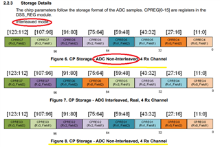

In app note AWR1xxx and AWR22xx Data Path (https://www.ti.com/lit/an/swra555a/swra555a.pdf) I found below info.
My questions are as below.
1. Is the figure 6 and 8 shows the CP storage for interleaved ADC instead of non-interleave?
2. The title of figure 6 and figure 8 is same. The content different is figure 6 uses CPREG[4-7] and figure 8 uses CPREG[0-3]. What's the condition (use case/config case) for figure 6 and figure 8?
3. As for AWR2243, the CP data is outputting from CSI2, instead of getting by reading register. What's the relationship between the CP storage and CSI CP data output format in interleave/non-interleave/complex/real condition?
