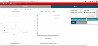

Hello Team,
I collect some of the data through DCA1000 by using CLI command Interfance. Then for the parser I used parser example scripts available at the SDK folder. But I got some error when I parse the bin file. Below are the steps and figures.
1) First profile_2d was provided to mmwave demo visualizer.
2) Then cli command was run which stored bin file.
3) Then I open the lvds_example script provided the above cfg file and prefix as shown below.
4) but here I got some errors. the error changes as I change the parameters in lvdsStreamcfg.

  • Hi Pedrhom,
    Sorry for being late. I tried it.
    Can you try doing LvdsStreamcfg 1 1 1 1
    But I got an error which is shown below.
    I load this profile to mmwave demo visualizer but I got this error. Profile.cfg is attached as well.

  • Hello Fahad,
    Is there a reason you are trying to do lvdsStreamCfg when running the mmWaveDemoVisualizer? The lvdsStreamCfg line is specfically for pulling raw data and utilization of the lvdsStreamCfg command assumes that you have a host processor (DCA1000) actually capturing this LVDS data stream.
    Pedrhom Nafisi
  • Is there a reason you are trying to do lvdsStreamCfg when running the mmWaveDemoVisualizer?
    I just clicked on load config from PC and send as shown below, and then load the profile.cfg as attached above. Then it gives me this error(as shown above).
    But when I used the same profile.cfg for parser and then set LvdsStreamCfg -1 0 1 0 , it gives me the following output as in text file. But the sw_output.csv

    Let me explain step by step.
    1) I flashed the bin file using uniflash for mmwave demo visualizer.
    2) Then open mmwave demo visualizer on google chrome and select ports and my device.
    3) Then load config from PC or some time directly send config to device and device starts sensing and I see the plots.
    4) I already connect DCA1000 during experiment and using CLI command I able to capture the data saved in bin file through DCA1000 along with log file.
    5) I then opened the python LVDS script as indicated above and give cfg file and data prefix and run the script and get the above errors when changing LvdsStreamCfg command.
    Fahad
