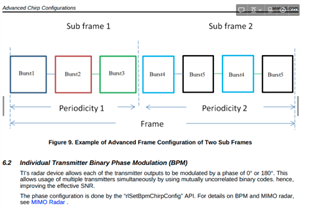

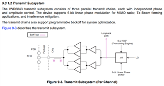

I seem to have found conflicting information regarding what kind of phase offset modulation is possible using the IWR6843.
In the SDK user's guide, we see the following:
However the datasheet says:
which one is correct? Does the IWR6843 have six bits of phase offset modulation or just one?
