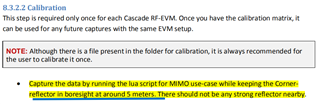

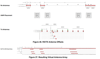

The structure of 12 transmitters and 16 receivers of the MIMO mode subordinate radar means that its antenna aperture D=85 * lambda/2=165mm. According to the far-field determination formula, Rff=2 * D ^ 2/lambda=13m. Soit is finally calculated that the far-field is about 13m away, that is, it is considered to be a far-field beyond 14m. But why  the mmwave_ studio_ cascade_ user_ guide.pdf emphasize the calibration should be carried out beyond 5m, but 5m should be in the near field theoretically. I don't understand the theoretical basis for this?
In addition, if the MIMO mode of cascaded radar is used for measurement in the near field, such as at a distance of 1 m to 5 m, should near-field angle estimation and near-field correction be used? Is there any reference for TI?

    Range calibration is performed. For this type of calibration near field effect does not have an impact.Near field has an impact for phase error.
    Please see section "Near Field Correction"  in
    Millimeter Wave (mmw) Demo for XWR16XX
