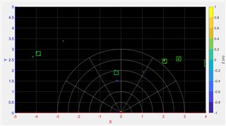

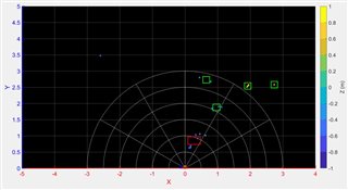

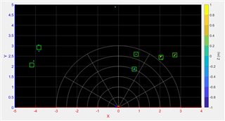

On the GUI ods_3d_visualizer.exe graph, although you can see something marked out in a distance, when a real person enters the sensing area, it is only sensed within 2m.
Are there any other parameters that need to be corrected to allow the program to detect something that is actually farther away?
When the person is at 1m (the red box):
When people fall back to 2m (green box right in the middle of the screen):
People back to 2m (no one detected):
Could you help check this case? Thanks.

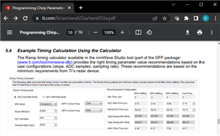

    Regarding the mmwave-dfp and mmwave-studio of section 5.4 in Programming Chirp Parameters in TI Radar Devices, is the difference between the two different IC models that apply?
    MmWave-DFP is available for AWR1243, AWR2243. While the mmWaveSensingEstimator in mmWave-studio works with xWR1243, xWR1443, xWR1642, xWR1843, xWR6843, xWR6443.
    The customer is using AWR1843AOP. Is it ok to directly use mmWaveSensingEstimator to configure the required parameters or is the mmWave-DFP tool also common?

  • Hi Saswat Kumar,

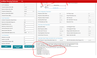

    For example, as you can see below, use mmWaveSensingEstimator to generate the following values:
    profileCfg 0 60 7 4.1 97.29 0 0 32.54 1 625 6779 0 0 30
    channelCfg 15 7 0
    adcbufCfg -1 0 1 1 1
    chirpCfg 0 0 0 0 0 0 0 1
    chirpCfg 1 1 0 0 0 0 0 2
    chirpCfg 2 2 0 0 0 0 0 4
    frameCfg 0 2 15 0 100 1 0

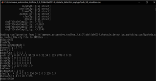

    Then update these parameters to .cfg to generate follows:
    sensorStop
    flushCfg
    dfeDataOutputMode 1
    channelCfg 15 7 0
    adcCfg 2 1
    lowPower 0 1
    guiMonitor 1 1 0 0
    cfarCfg 1 4 12 4 2 8 2 256 30 2 0 5 100 0.5
    dbscanCfg 4 4 13 20 3 256
    sensorStart

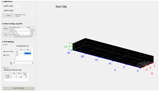

    Then use the GUI to load .cfg:
    Although it looks like it can be loaded, the GUI does not show anything:
    Thanks and regards,
    Cherry

  • Hello Cherry,
    The obstacle detection experiment is customized for the 2m range. Please ask the customer to use the out of box demo instead.
