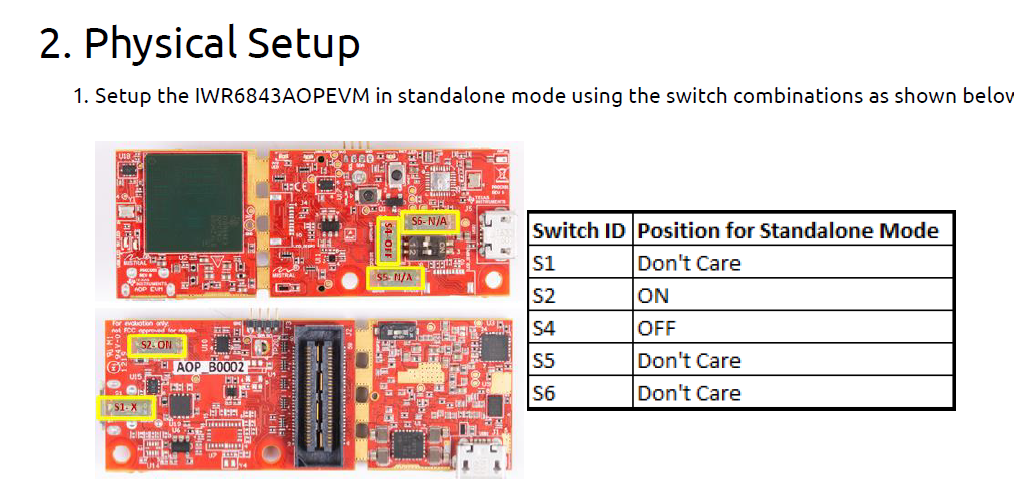

Q1: In this handbook, the device required is IWR6843AOPEVM (https://www.ti.com/tool/IWR6843AOPEVM ), which is the sensor I have, but in the following content, the handbook uses the sensor in the picture which is different from the previous link. They have the different layouts and how do I do the physical setup?
Q2: I find a video (https://training.ti.com/hardware-setup-iwr6843aop?context=1128486-1139154-1147566 ) which is using the sensor I have. Can I follow this video to do the physical setup?
Q3: After the physical setup in the video, can I follow the handbook for the subsequent operations?
