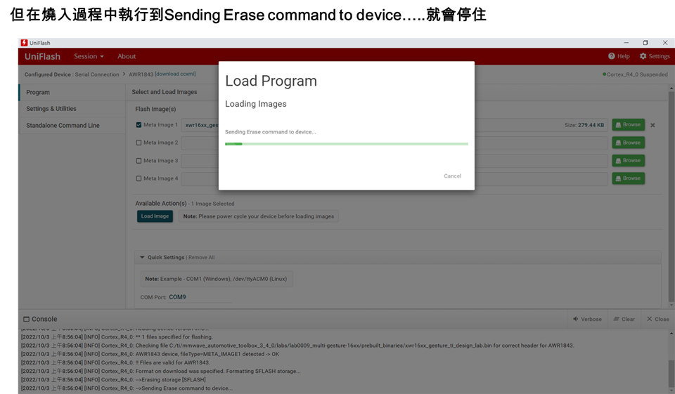

He can use uniflash to program AWR1843BOOST. But he failed to program his own board. It stuck at Sending Erase command to device…..
Below are the steps.
Win10
5V/3A
 uniflash_8.0.0
 ti\mmwave_automotive_toolbox_3_4_0\labs\lab0008_automated_parking\prebuilt_binaries\pa_18xx_mss_demo.bin
Uniflash stuck at Sending Erase command to device…..
[2022/10/6 下午3:17:08] [INFO] Cortex_R4_0: Initialization complete.
[2022/10/6 下午3:17:08] [INFO] Cortex_R4_0: Flashing process starting...
[2022/10/6 下午3:17:08] [INFO] Cortex_R4_0: Connecting to COM Port COM9...
[2022/10/6 下午3:17:08] [INFO] Cortex_R4_0: Reset connection to device
[2022/10/6 下午3:17:09] [INFO] Cortex_R4_0: Set break signal
[2022/10/6 下午3:17:09] [INFO] Cortex_R4_0: Connection to COM port succeeded. Flashing can proceed.
[2022/10/6 下午3:17:09] [INFO] Cortex_R4_0: Reading device version info...
[2022/10/6 下午3:17:09] [INFO] Cortex_R4_0: ** 1 files specified for flashing.
[2022/10/6 下午3:17:09] [INFO] Cortex_R4_0: Checking file C:/ti/mmwave_automotive_toolbox_3_4_0/labs/lab0009_multi-gesture-16xx/prebuilt_binaries/xwr16xx_gesture_ti_design_lab.bin for correct header for AWR1843.
[2022/10/6 下午3:17:09] [INFO] Cortex_R4_0: AWR1843 device, fileType=META_IMAGE1 detected -> OK
[2022/10/6 下午3:17:09] [INFO] Cortex_R4_0: !! Files are valid for AWR1843.
[2022/10/6 下午3:17:09] [INFO] Cortex_R4_0: Format on download was specified. Formatting SFLASH storage...
[2022/10/6 下午3:17:09] [INFO] Cortex_R4_0: -->Erasing storage [SFLASH]
[2022/10/6 下午3:17:09] [INFO] Cortex_R4_0: -->Sending Erase command to device...

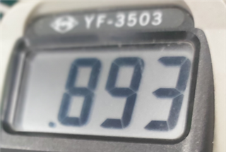

    Did you check to see if the radar is waking up properly? First, put the device into development mode (SOP0 and SOP1 closed). If you probe the XTAL_P pin of the device you should see the 40MHz signal. If you probe the VBGAP pin you should see 0.9V.

    A:If you probe the VBGAP pin you should see 0.9V.
    B:Measurement photo:

  • Hello Wendy,
    It looks like the radar is waking up properly, so I do not expect any issues on the radar side.

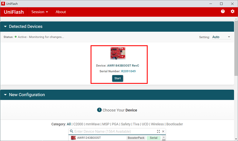

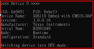

  • Also, in addition to above, can you confirm if the customer has programmed the XDS110 firmware on the custom board?
    This should be done according to the instructions in the below thread:
    https://e2e.ti.com/support/sensors-group/sensors/f/sensors-forum/827266/awr1642-custom-board-is-not-detected-by-usb-comm-port/3060977#3060977
    Adrian
  • Hello Adrian,
    A:Also, in addition to above, can you confirm if the customer has programmed the XDS110 firmware on the custom board?
    B:I have performed the XDS110 firmware steps on a custom board.
    A:It seems like the flash should meet the requirements of the bootloader so I expect it should work. Can you share the schematic connections between the flash and the radar and confirm that all of the correct pullups are connected?
    B:I measured the signal of the circuit near the Flash, and there is a difference compared with the TI board. After replacing the resistor, the Flash can be programmed normally.
