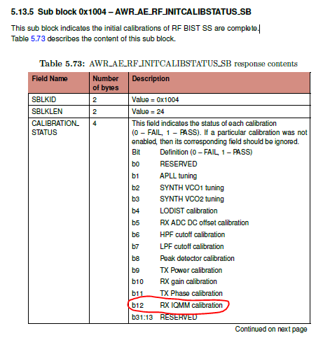

Recently I have received an "initial calibration status async event" (subblock ID 0x1004) from the RF BIST SS indicating that the RX IQMM calibration failed:
Calibration status = 0x0FFE instead of 0x1FFE -> bit 12 (RX IQMM calibration) = 0 (see image below from the interface control specification of the RF BIST SS)
This error has happened multiple times recently but sometimes disappears after a reset of the device.
What is "RX IQMM calibration"? What is done by the RF BIST SS during RX IQMM calibration? What could make it fail?
