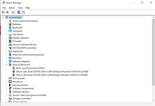

We are unable to find the XDS110 driver for AWR1843AOPEVM when connected to DCA1000EVM. Please help me to find the respected drivers as soon as possible.

If the intent is to capture raw data with DCA1000 you will not need the XDS110 driver.
You will need to install the FTDI drivers. Please see "FTDI" drivers in the DCA1000 Debug Handbook
[FAQ] DCA1000EVM: DCA1000EVM Debug Resources - Sensors forum - Sensors - TI E2E support forums
Thank you
