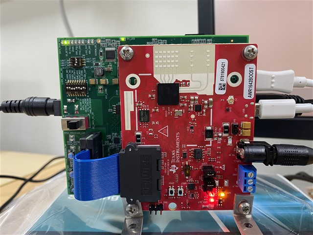

The errors listed below, as well as my efforts to correct them, were unsuccessful.
I purchased an EVM AWR1642BOOST and DCA1000 and attempted to acquire data using the DCA1000 training video.

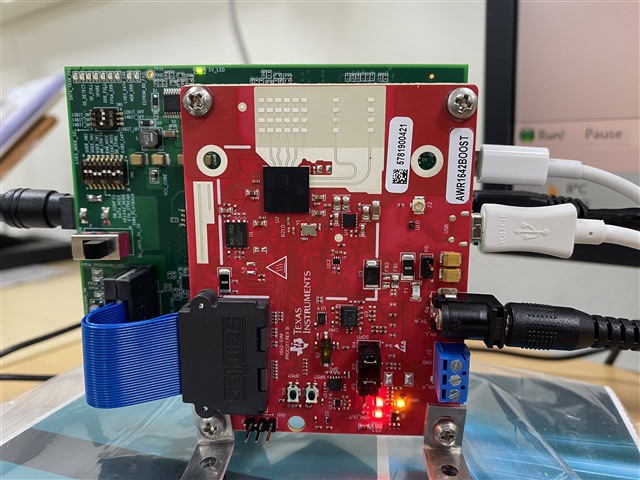

  1. While in development mode(SOP 0, SOP1 closed, and SOP 2 open), I ran into a hardware fault (the NERR OUT led is red just after supplying power to EVM).

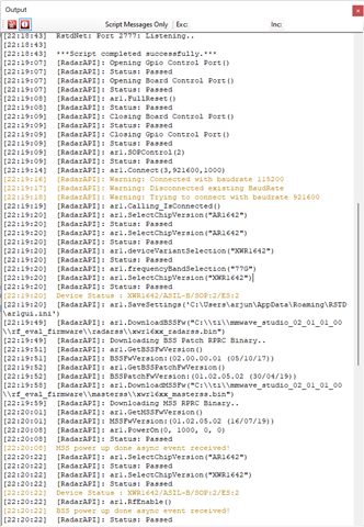

  2. I carried out the current hardware error. When I clicked the SPI Connect button in mmWave Studio, I found NERR OUT was off.

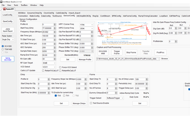

  3. Then I get the following problem in StaticConfig when selecting Regular ADC mode in LP Mode: [22:22:29] [RadarAPI]: Status: Failed, Error Type: REGULAR ADC MODE NOT SUPPORTED IN 5 MHz PART VARIANT DEVICE
I disconnected the DCA1000 and used the device's out-of-the-box demo to make sure the EVM was operating flawlessly. The default demo ran successfully.
Finally, I wiped the previous flash (SOP 0, SOP 2 closed, and SOP 1 open) with Uniflash and attempted to flash the BSS and MSS anew with mmWaveStudio. But I made the same error.
The NERR OUT led turns red when power is applied.
Please examine the pictures below and provide a solution.
Arjun
    The errors you are seeing are due to incorrect configuration, not due to a hardware issue. First, you need to set the ADC to low power ADC mode. For AWR1642 only low power ADC mode is supported.
    Second, the max sampling rate is 6.25Msps for complex 1x mode. You are trying to set 10Msps. You need to reduce the sampling rate to 6.25Msps for complex 1x.
    If you fix the above issues this should resolve the errors you are seeing.

  • Hi Aozer,

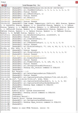

    I followed your suggestion but I failed to set DCA1000. I have been getting errors at reading FPGA Version. Please see the below screenshots and suggestions.
    Arjun
    The error means that the DCA1000 is not connecting properly, so now it seems like the issues with the sensor configuration are resolved. Can you try following the steps in the below video to connect the DCA1000?
    https://training.ti.com/dca1000-training-video
    You need to make sure you are properly setting up your IP address or it will not connect. In some cases, if your PC has a firewall it can also cause issues, so you should disable any firewalls when using the DCA1000.
    Adrian
  • Hi Aozer,
    I have been following the DCA1000 training video shared by you.
    I noticed these issues:
    1. The NERR OUT led is read immediately after power is applied and turned off when the SPI connect button is pressed.
    2. When power is applied, the NERR OUT led is off, but it turns red when the MSS FW is loaded.
    3. The NERR_OUT led stays red.
    Please see the images of the EVM as well as the current and previously shared screenshots.
    I believe a hardware error is present in the device.
    Let me know if you want me to send you a video recording.
    Arjun

  • Hello Arjun,
    Very sorry for the delay, there have been many escalations over the past few weeks that I had to prioritize.
    Can you follow the steps in the below link to initiate a return based on where you purchased?
    https://www.ti.com/support-quality/additional-information/customer-returns.html?keyMatch=CUSTOMER%20RETURNS

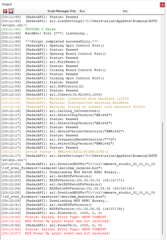

    In the mean time, before you were able to do the RF power on without the response timeout. Now, you are seeing a response timeout at RF Power on. If you power cycle both boards does this same error always occur?
    Also, the error you were previously seeing with the DCA1000 FPGA version is not related to the NERROR. Even if you receive a new board you will still see this issue. Can you share a sceenshot of how you are configuring your IP address?
