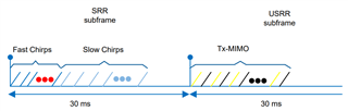

I have a question on multimode configuration for cascaded radar like page 7 of Short Range Radar Reference Design Using AWR1642
In my case, I want 2 sub-frames, for the first sub-frame 1 TX and 16 RX antennas will be used with 32 chirps, for the second sub-frame 12 TX and 16 RX antennas will used in TX-MIMO with nchirp_loop equals to 32.
My question is where can I find example of such configuration for Lua files? Any suggestions? I understand there is a TX-beamforming example with advanced chirp configuration. However, it does not apply to my case.

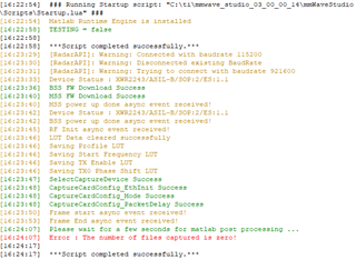

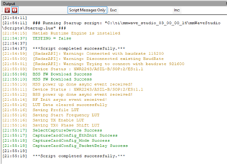

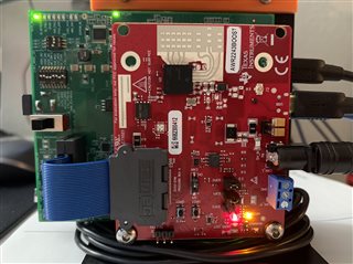

    Thank you very much! I was trying to run this LUA script (Advanced_Chirp_Example.lua) with a AWR2243Boost and DCA1000EVM as below.
    However, I always failed to capture the raw data with the given Advanced_Chirp_Example.lua script. From the log, I could successfully load the firmware and run. However, it always failed to capture the data. Do you have similar experience? I feel some chirp configuration might be wrong.
    I also tried to capture raw data with a simple MIMO LUA file. I can successfully capture the data. That's why I feel some configuration of Advanced_Chirp_Example.lua might be wrong.

        Seems you have commented the capture path. Hence when you might have issued the ARM of DCA the capture path was not correctly configured the ARM did not happen correctly.

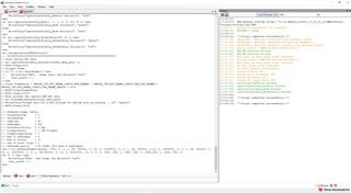

    I attached the LUA file I used.
    4150.Advanced_Chirp_Example.zip

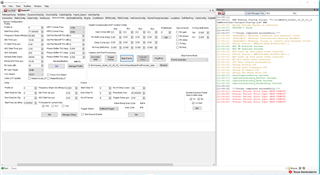

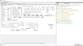

    Here are my detailed steps.
    (1) I used the LUA file to configure the AWR2243Boost and DCA1000EVM. There was no problem.
    (2) Then, I switched to the SensorConfig Tab.
    (3) I first clicked the DCA1000 ARM button. There was no problem. However, every time I clicked the "Trigger Frame" button, it gave the error of "Status: Failed, Error Type: RESP TIMEOUT" as below.
    (4) There was no problem with the DCA1000EVM connection to the computer. As I previously tested that the MIMO configuration LUA file worked well.
    Any suggestions?
    Thanks!
    Hang
  • Hi Hang,
                    After you comment out the capture API call, just before the manual trigger try re-issuing the Advance Frame API and see if it issues an error. If it does then try to match the values being sent in the API. For example, The current API send 40Ksps, try to reduce it to 25Ksps and check.

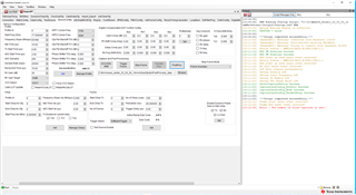

  • Hi Abhed,
    It still didn't work. I feel the chirp or frame configuration in the given lua file was not workable.
    (1) I loaded the Advanced_Chirp_Example.lua file and then re-issuing the Advance Frame API. No error occurred.
    However, when I clicked "Trigger Frame" button, it gave the error of "Status: Failed, Error Type: RESP TIMEOUT".
    (2) I also tried to change the sampling rate. No error for during configuration. However, when I clicked the "Trigger Frame" button, the mmWave studio seemed freezed and after a while it showed me "Error: The number of files captured is zero!"
    I feel the chirp or frame configuration in the given Advanced_Chirp_Example.lua was wrong.

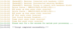

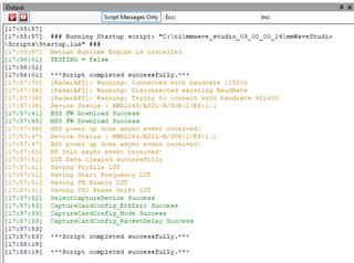

    Thank you very much! This time it still gave me some error as below.
    However, I found the LED was blinking and a bin file was generated.
    Any suggestions?
    I attached the lua file I used. The only difference is that I added the serial port setting at the very beginning.
    6281.Test_Adv_Chirp.zip
    Thanks again for the time and help!
    Hang
        Ok so the capture setup seems OK.
    The error you get is of post processing. Did you check the content of the captured data?
