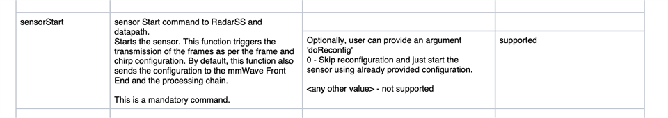

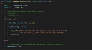

But when executing below commands, it returns error.
mmwDemo:/>sensorStop
sensorStop
Done
mmwDemo:/>sensorStart 0
sensorStart 0
Error: You have provided partial configuration between stop and this command and partial configuration cannot be undone.Issue the full configuration and do "sensorStart"
Is the "sensorStart 0" command correct?
