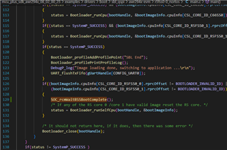

Using the QSPI SBL from SDK v04_02_00_02, I am getting quite long boot times. The MMW demo image size is 725KB:

  • Hello ERIK,
    This is the expected time, and this happens because of the SOC_rcmWaitBSSBootComplete(); that is there in the C:\ti\mmwave_mcuplus_sdk_04_02_00_03\mcu_plus_sdk_awr294x_08_02_00_25\source\drivers\bootloader\soc\awr294x\bootloader_soc.c.
    This is because the BSS boot does take a long time, and this is executed in the QSPI SBL.
    One of the changes you can make is:
    Go to the bootloader_soc.c and then make the following changes
    Then go the file C:\ti\mmwave_mcuplus_sdk_04_02_00_03\mcu_plus_sdk_awr294x_08_02_00_25\examples\drivers\boot\sbl_qspi\awr294x-evm\r5fss0-0_nortos\main.c
    Add the necessary header files if required and then rebuild the driver and then the SBL_QSPI application.
    This should reduce the time taken by the boot.
    Saswat Kumar
  • Saswat,
    Thank you. This change helped. The boot time was reduced by ~50% with this change.  Total time is now ~850ms.
    It looks like the four calls to Bootloader_loadCpu() take close to 800ms combined. Is there anything that could be implemented to optimize that process?
