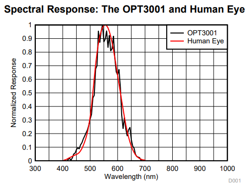

Hi Team,
Do we have data of a quantum efficiency for this IC?
Thank you.
Hi May,
The spectral response of the OPT3001 is shown below.
Thank you,
