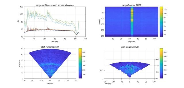

The SMRR was configured according to the parameters of BF mode data collection given by the example code to configure SMRR, anglesToSteer=[-30:2:30]. The generated Rang-Angle Diagrams of the Static Object are correct and are as follows:
But after I set anglesToSteer=[-60:1:60], the collected data has problems with the ranges under certain BF angles (there were no changes to the environment) as follows:
Such problems emerged as I generated data for several times. Was it because the angle I set was too large? But in the technical handbook, anglesToSteer=[-60:0.5:60]. Or are there any other factors that I must consider?

    2) "anglesToSteer=[-30:2:30]" Can you let us know what this actually implements on the device. Are you moving on steps of 2 degrees? The device has a single step of 5.625 degrees
    3) What is the percentage of error you are observing in both the cases?

    2) anglesToSteer=[-60:1:60], I wanted to achieve angle scanning from -60° to 60° with a step of 1°. For The single step of the device is 5.625°. First of all, "anglesToSteer=[-30:2:30]" is the example code, and on page 18 of Imaging Radar Using Cascaded mmWave Sensor Reference Design.pdf, the sentence 'The TX beam is steering within [–60 60] with step size of 0.5 degree' suggests that the step can reach 0.5°. So, my understanding is the scanning angle of BF is not of the same physical quantity as the 5.625° that you mentioned?
    3) After testing, I found that if anglesToSteer*nchirp_loops<2048 (they were all parameters in USRR/LRR/SMRR), the same situation as above would not appear. For example, under the frame based steering mode, if the chirp value of every angle is set at 64, then the maximum scan angle should be less than 32. So, what is the reason for this? The manual doesn't seem to have mentioned it.
