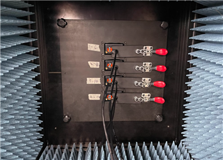

In order to save the testing time, we test 4 AWR1642 Radar's RF performance in chamber at the same time.
Since the FWs (Profile configuration, Chirp configuration..etc) are the same, whether there will be mutual interference problems?
* We put 5 corner reflectors with RCS 1 in chamber.
* We check the received power (dBm) value for the PASS/FAIL condition.
* The 4 Radar's position is shown as below figure while testing. (Outside of chamber view, Inside of chamber with 5 corner reflectors)
