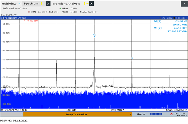

we design our own board with 4 AWR2243 (ES1.0) chips in cascade.
To analyse the quality of the tx signal, we set contious mode with the function
rlSetContModeConfig
and
rlEnableContMode
In the spectrum we can see a 40MHz signal overlapped with tx output signal. We assume that the 40MHz signal comes from the quartz crystal "XTAL".
We see this effect on all tx-antennas and in the complete frequency range (76-81GHz).
Have anyone see this effect also on the ESM evalution board?
Hope anyone can give a feedback

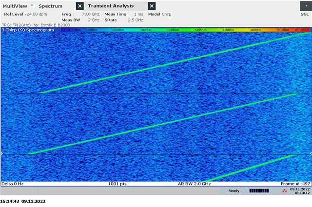

    we can not measure this effect in FMCW mode. But we are not sure if this effect also occour in FMCW mode.

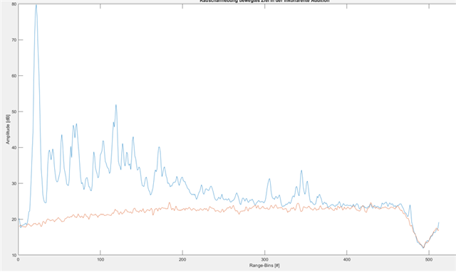

    We have problems with strong targets. With strong targets the noise in the range direction will be increased. We can explain this by bad phase noise, unlinear fmcw ramp or a parallel ramp as we can see in cw mode.
    Here you can see two range slice from Range-Doppler-Map. The red graph is a doppler bin without any target and represent our noise. The blue graph is a walking person in distance of about 1,2m. We can not explain the blue graph from range bin 50 to 250.
    2. Why have a walking person in 1,2m distance impact of 200 rangeBins (6m).
