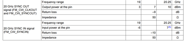

    As the pic shows, the typical output power of 20GHz LO signal is 7dBm, but i'm confused about the min and max power,
1. 3~10dBm, why the difference is so big ?
2. Is there an automatic controller to adjust the output power according to the SYNC IN signal ?
3. If there is no automatic controller, when the output power is 10 dBm, and the loss is smaller than 3dB, then the input power is bigger than 7dBm, what will happen ?
Thank you very much !
