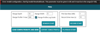

I am using TI's mmwave demo visualizer and IWR6843ISK to do very fine motion, the test tools version as below
1:mmWave Demo Visualizer 3.6.0
2.BIN:from toolbox 4.12.1 out_of_box_6843_isk.bin
cfg:68xx_fine_motion.cfg(https://dev.ti.com/tirex/explore/content/mmwave_industrial_toolbox_4_12_1/experiments/images/Very+Fine+Motion+Detection+vs+PIR/68xx_fine_motion.cfg)
but I can't get the right result , I think the cfg file is not mapped to latest mmwave visualizer or device BIN code, please advise me how to get updated cfg file,.
The error message as below I saw.
  • Hello.
    We do not update the configurations for experiments.  However, you are free to change these settings to update your environment/make compatible with the current visualizer.  You can refer to the sdk user guide to figure out how to modify any commands that may be out of date to work with the current visualizer.  In this case, keeping the max threshold for CFAR high(you can experiment with this value; 100 being the highest CFAR threshold, and 0 being the lowest) is recommended as you want static points to not be detected.
