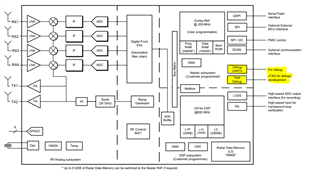

    Is it because of the board design that I can't debug two cores at the same time? Or can both cores be debugged when a custom design is made? In the functional diagram, it is given as JTAG and UART for debug.
    You said that debug SOP switch setting is for a different kind of debug. Which type of debug? Please, could you explain this?
    Thank you.
    No, you would not be able to debug two cores at the same time.
    -Shareef
