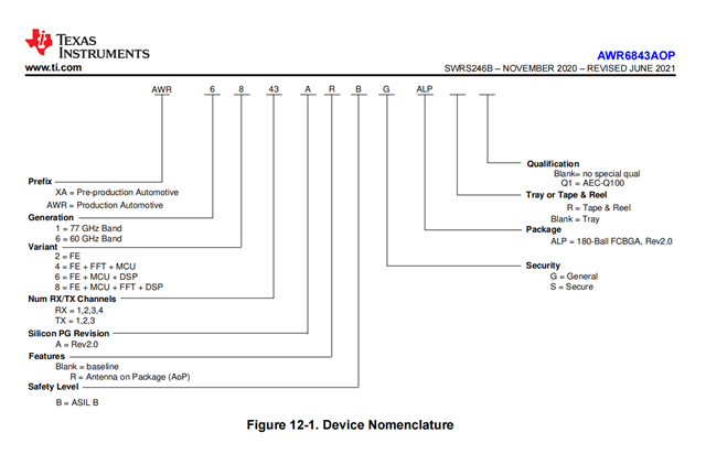

I want to know the difference between General version chip and Secure version chip. Can you clarify it?
Yunlong
Yunlong
General version doesn't contain any HW crypto built into the device. The secure variants have HW crypto and secure storage built into the device that can be used for secure boot and image authentication.
