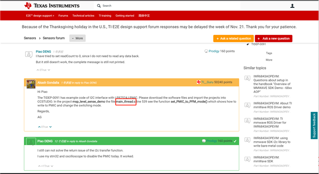

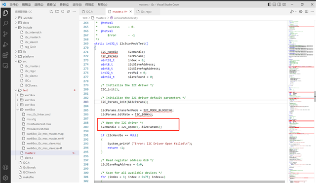

    1. If I2C slave-devices is more than one, How to decide the index (Logical peripheral number for the I2C indexed into the I2C_config table) when I use the api I2C_open?
    In the <SDK_INSTALL>/packages/ti/drivers/i2c/test. the index is 0 (see the follow picture). But if there is more than more one device linked the I2C Bus, I don't know what to do. Do I need use I2C_open(0, &i2cParams),I2C_open(1, &i2cParams),I2C_open(2, &i2cParams)...?
    2. I'm not clear that in the struct i2cTransaction, i2cTransaction.slaveAddress is the real SlaveAddress (such as 0x90) or the index(Logical peripheral number, such as 0,1,...). These two I have see and I am not clear which one I should choose.
    You should only need to use I2C_open(0, &i2cParams).
    For i2cTransaction.slaveAddress, the real address should be used. The I2C address for the TMP112 can be found in the AWR6843AOPEVM schematic.
