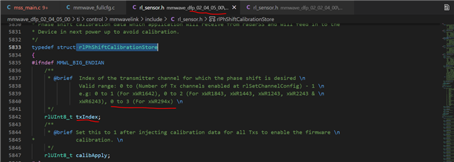

      I have downloaded SDK 4.3.0.1 and there still the same command in rlPhShiftCalibrationStore definition as below
    There still do not have the definition of Tx3.
    Can you help me to confirm the data format of calibration structure and the phase compensation mechanism behind the calibrating each code word of phase shiftier?

  • Hi Lin,
              Please find the snip from mmWave DFP 02_04_05_00 in mmWave SDK 4.3.0.1:
          Can you please confirm if use of this solves your issue?

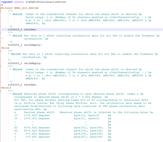

  • Hi Akshay:
      There definition of Tx3 is clearly for your attachment, but there still some hesitations about phase shiftier calibration,
    Let me describe the procedure as below,
    1.Turn off FW based boot time phase shiftier calibration
    2.Set 4 Tx in TDMA mode and the phase for the chirp sequences
    [Tx0code0 Tx0code1.... Tx0code63 Tx1code0 Tx1code1... Tx1code63... Tx3code0 Tx3code1 Tx3code63]
    3.Calculate the phase and stored in flash in increment order (n = 0 1 2 3 ~63)
    gCalibDataStorage.phaseShiftCalibData.PhShiftcalibChunk[0].observedPhShiftData = {0,27,48,66,82....}
    gCalibDataStorage.phaseShiftCalibData.PhShiftcalibChunk[1].observedPhShiftData = {0,27,48,66,82....}
    gCalibDataStorage.phaseShiftCalibData.PhShiftcalibChunk[2].observedPhShiftData = {0,27,48,66,82....}
    gCalibDataStorage.phaseShiftCalibData.PhShiftcalibChunk[3].observedPhShiftData = {0,27,48,66,82....}
    4.Re start the sensor and read the data from flash、 restored the calibration data,after that, open the sensor.
    I have collected the phase response after calibration and the results are incorrectly and I have already checked the read/write function flash, it work.

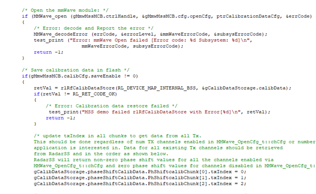

  • Hi Lin,
    Can you specify if you have set the TX index in your application code. (See one example config below)
    phShiftCalibData.PhShiftcalibChunk[0].txIndex=0.
    Also, can you specify what value you are setting in the structure member below.
    phShiftCalibData.PhShiftcalibChunk[0].calibApply
