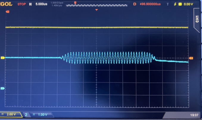

hi:
         At present, the TDC1000 has wave hopping. That is, after A detector head is sent to B, B detector head is sent to A. During this period, because the threshold value is the same, but the deviation of the echoes received by A and B will cause A and B to switch to different echo pulses, resulting in a difference of N us, commonly known as wave hopping. Is there any way to solve this problem
The following blue is the captured COMPIN waveform. It can be seen that the amplitude of the middle waveform is almost equal, so the threshold value can easily switch to pulses at different positions, leading to wave hopping.

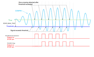

    Notes on the COMPIN signal provided:
    Even though the signal at the COMPIN signal portion is almost equal this should not really matter, I am not sure what receive mode the customer is using on their system but the STOP signal is supposed to generate after the first zero cross once the threshold is met, as demonstrated in the image below. This is true for single echo and multiple echo mode. The only difference is that single echo will generate a pulse after every single zero cross and multiple echo will generate one long pulse until the threshold is not met.
    If I understood the issue correctly, I think the main problem though might stem from a bug on the TDC1000 device. The bug is that the device can sometimes miss the first zero crossing pulse generation, that means that even though the signal met the threshold, at the first zero cross the STOP signal might not generate. As a workaround to this bug we normally recommend to take the average of a couple of measurements, this will help reduce the us of error caused by the missed pulse.

        We use TDC1000 in this case:
    We want to send pulses from unit A and receive pulses from unit B at T1; The pulse is sent from unit B and received by unit A. The time is T2. The flow rate is calculated by subtracting time T2 from time T1. We now find that when the water completely submerges the A and B transducers, wave hopping will not occur. When the water does not completely submerge the A and B transducers, wave hopping is very easy to occur.
    So I want to know whether wave hopping is easy to occur when the transducer is not completely flooded, and whether there is any solution.

  • Wave hopping is actually a problem of zero crossing detection error. For example, if a trigger threshold is set, the STOP of A ->B will be generated in the fourth pulse, but B ->A will be generated in the fifth pulse, which is equivalent to that B ->A skips the fourth pulse, detects the fifth pulse, and skips a pulse.
    At present, we find that wave hopping is now the case when the transducer is not completely submerged. If it is completely submerged, there will be no such phenomenon.

  • Hello Chao,
    I think it may be easier to use an image to describe the issue, so I have included an image below. In the top red waveform shows the behavior of a TDC1000 that is operating as it intended, but the bottom shows the issue with the zero-cross comparator bug that I mentioned. Even though the signal at the zero cross comparator is enough to trigger a STOP pulse, when the bug is present the device will miss the first STOP pulse generation. Meaning that it will generate the first STOP where the second STOP pulse should be. This can cause some delay in your measurements which is why this is not the most accurate solution. The missed zero cross does not happen every measurement which is why averaging can help reduce the impact of the missed pulse.
    Isaac
  • Hello Isaac,
         Thank you. I understand the zero crossing error of the TDC1000. This looks like the same phenomenon as what I said about wave hopping. At present, as long as the transducer is completely submerged, it seems that there is no such zero crossing detection error during our test. Only when the transducer is submerged half or 90%, wave hopping is easy to occur. Especially when the transducer is flooded by 90%, the probability of abnormal value and normal value caused by this wave hopping phenomenon is 50%, which should not be zero crossing detection. Therefore, whether there is a necessary condition for the TDC1000 usage scenario is that the transducer needs to be completely immersed.
