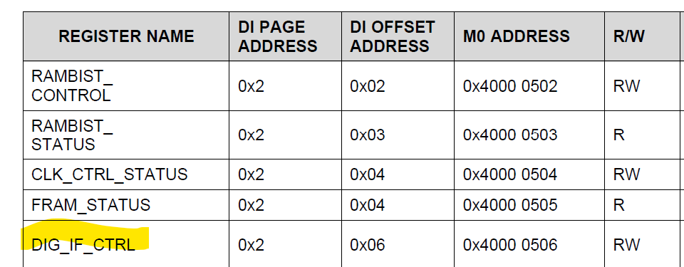

    ->Is SPI is enable per default? If not, how can I activate it?
    Yes, SPI and OWI are enabled by default. They can be found in the DIG_IF_CTRL

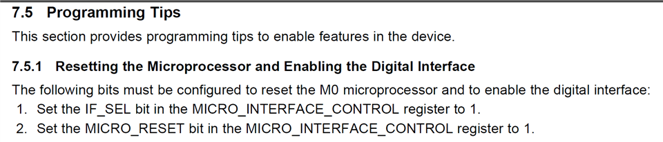

    As a reminder, its best to make sure the M0 is in reset when accessing register space. This is described in the programming tips section of the datasheet.

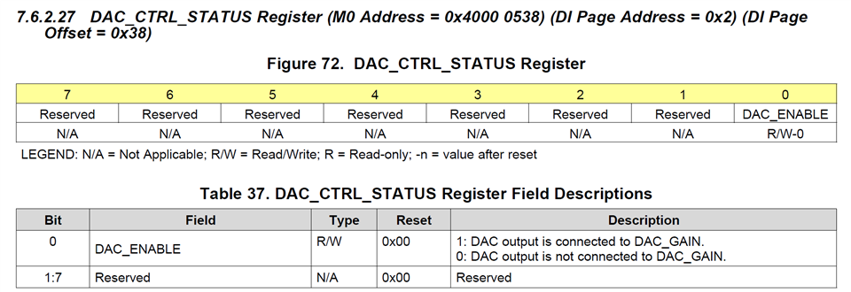

    ->Is DAC output is enable per default? If not, how can I activate it?
    The DAC is disabled by default and can be enabled by the DAC_CTRL_STATUS register space.
