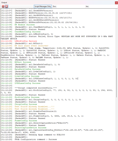

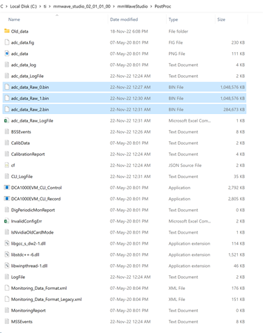

I've built two scripts, init_mmwave_Studio.lua and transmit_signal.lua, based on the mmwave studio script. As per requirement of the project, I was able to capture the data for 8 minutes, which was confirmed by the size of the data.(See Pic-1). I have, however, been experiencing two errors.

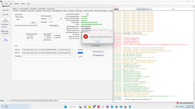

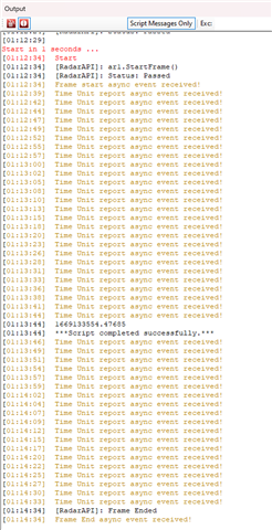

  1. The script publishes the message "***Script completed successfully.***" after 1:10 seconds and the message "Frame Ended" after 2 minutes(See Pic-2). In fact, it should be displayed after 8 minutes if the script is successfully completed. Could you please review the given script and assist me in resolving the issue?
  2. There is repeated printing of the message "Time Unit report async event received!" Could you please explain what this notification means and ensure that the data is being collected correctly?

  • Hi Cesar,
    I made the changes as per your suggestion, but it shows the additional LP mode failure. Please see the below screenshot. I would also like to highlight that data is being collected while the NERR_OUT Led is red(See video file).

    I received the same error with another error. Can you also tell me the meaning of the I am getting?

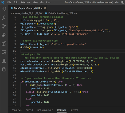

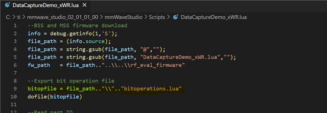

    So the error you are getting here is due to mmwavestudio not being able to locate the bitoperations.lua file which is referenced in DataCaptureDemo_xWR.lua. It seems like it is looking for the file inside C:\ti\mmwave_studio_02_01_01_00\\ directory when it should be looking inside C:\ti\mmwave_studio_02_01_01_00\mmWaveStudio\Scripts.
    To ensure the problems you are having are not related to missing files or incorrect file paths, could you verify that you have a bitoperations.lua file located inside your mmwave studio directory which in this case would be C:\ti\mmwave_studio_02_01_01_00\mmWaveStudio\Scripts and check that the DataCaptureDemo_xWR.lua file has the correct pathways as shown below
    Let us know what results you get after verfiying
    best,
    Bhuiyan
  • Hi Bhuiyan,
    I verified that the bitoperations.lua file is in the C:\ti\mmwave_studio_02_01_01_00\mmWaveStudio\Scripts directory, and the DataCaptureDemo_xWR.lua file has the correct path as well. Please check the attached screenshots.

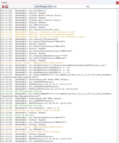

  • Hey Arjun,
    We are still concerned this issue may be due to incorrect file paths. We noticed that in your screenshot, the file path for your BSS FW and MSS FW are not the default filepaths. When mmwave studio is installed, the device specific firmware is located in the C:\ti\mmwave_studio_02_01_01_00\rf_eval_firmware folder while in your configuration it is looking for the firmware in C:\ti\mmwave_studio_02_01_01_00\Scripts\..\..\rf_eval_firmware.
    I recommend deleting and reinstalling mmwave studio as this is a novel issue that maybe due to mmwave studio being unable to find all the files referenced in your lua scripts. Try running the scripts after reinstalling and let us know the results

  • Hi Arjun,
    I recommend reinstalling mmwave studio and placing and running your scripts from C:\ti\mmwave_studio_02_01_01_00\mmWaveStudio\Scripts folder. That is is the environment the example scripts from TI are designed to run in.
    If you want your lua script to be path independent, you can include full file paths for all the references to other files in your script as I see you friend has done for some of his paths, but I can not verify if that is the case for all their paths. Your current mmwave studio environment is modified which is why some TI scripts are not working. DataCaptureDemo_xWR.lua is designed to be run from C:\ti\mmwave_studio_02_01_01_00\mmWaveStudio\Scripts and not from C:\ti\mmwave_studio_02_01_01_00 as it looks like in your screenshot. The script will fail if it is not run from the correct folder. This why the recommendation is to reinstall mmwave studio to reset to the default environment and running all TI provided scripts from the scripts folder and running custom scripts from the scripts folder or wherever the author of the script intended for them to run from.
