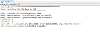

I'm trying to develop an application by adding the out of box application to CCS. I am sending the initialization values without using CLI interface.
The resume button is not enabled. Can I learn what caused this?
Then, I changed parameters like as screenshot below.
The output and exception errors are :
How can I fix this exception? How can I find the definitions of exceptions arguement and ID?
Thanks for your help.

    Have you seen the hard-coded config example in the mmWave Industrial Toolbox? This seems to be what you are trying to do.
    In the screenshot you have shared, it appears that the target code is running already, thus the resume button cannot be used.
    Please note, it is outside the scope of these forums for me to debug custom code on your behalf. That said, I would start by checking the line which is causing the exception.
