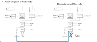

As shown in above figure ,  we want to synchronize the clock (frequency) of two  IWR6843, =>  the osc clock of master radar is fed to  the CLKP pin of slave radar.
First , the clock signal of master radar will be accessed from the Ultra-Miniature Coaxial Connector on the MMWAVEICBOOST Board.
But when we connect this interface to an oscilloscope, we can not observe any clock signal on the scope. why? (Do we need to enable this interface by software or?)

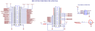

then , I found that this interface access osc_clock through the 60-pin HD connector, while the 60-pin is controlled by the switch.
As shown in above figure ,S1.4 to S1.9 are all related to the 60- pin HD connector . Should we turn off all of these switches to make sure the clock signal is available? and could you inform us where I could find more explanation about this switch?
