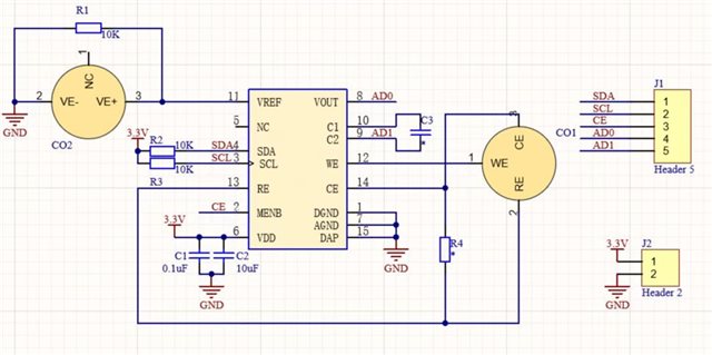

MCU:MSP430。PML91000 is used to collect CO, CO2, currently we are experiencing some configuration problems, please help take a look. We just added a gas collection function to the original meter module, and the program also added this part of the function on the basis of the original, and the configuration data and the block diagram are as follows:

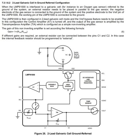

#define LMP_REG4_DATA     0xc0          //LMP 0xB0 见P22 参考电压为外部源,内部零选择(源引用的百分比)67%      //0xB0
#define LMP_REG5_DATA     0x01          //2-lead ground referred galvanic cell
Fetch data as configured above,as follows:
uint LMP_Read_Func(void)
    unsigned char  un8Date;
    un8Date = 0;
    PLMStartI2C();
    PLMWrByte(LMP_WRITE_ADDE);     //发送LMP91000地址
    i2c_WaitAck();
    PLMWrByte(LMP_REG3_ADDE);       //发送寄存器地址
    i2c_WaitAck();
    PLMStopI2C();
    PLMStartI2C();
    PLMWrByte(LMP_READ_ADDE);     //发送LMP91000地址
    i2c_WaitAck();
    un8Date = PLMRdByte(noACK);
    PLMStopI2C();                   //产生一个停止条件
    return (un8Date);
The return value is always 1
when  PLMWrByte(LMP_REG3_ADDE);      This step is changed to:   PLMWrByte(LMP_REG1_ADDE);The return value is 129, which should be the read state.
My question is:
1, is the configuration correct
2. Whether the process of fetching numbers is correct
3, how to parse the return value (no instructions on the document)
  • Aiwen,
    Try reading back the registers you wrote to see if the data in them is correct. Sometimes the micro controller can overdrive the LMP91000. Try adding a few clock cycles between each instruction. I know you have wait states, but sometimes you need a few more clocks before sending another command line.
