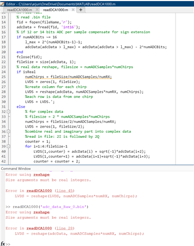

Running the MATLAB code to turn the adc_data.bin file into a matrix for further processing has been giving me errors.
Please review the screenshot in the attachment and offer

    Please note that you are not calling the function properly.
    It should be
    %%% Command to run in Matlab GUI - readDCA1000('<ADC capture bin file>')
    and not
    %%% Command to run in Matlab GUI - readDCA1000("<ADC capture bin file>")

  • Hi Cesar,

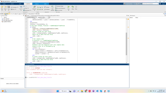

    I didn't say that the same faults happen in both directions. I use a different chirp configuration. Reshape function, line 45, contains the error. Please advise what modifications should be made to the provided MATLAB code. The screenshots show comprehensive details.

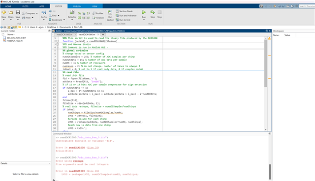

    Please make sure that the matlab script is updated as needed based on your configuration.
    I can see in your snapshots that adc_samples = 256, so "numADCSamples = 256" is still correct.
    What about "numRx"?
    thank you
    Cesar
    % change based on sensor config
    numADCSamples = 256; % number of ADC samples per chirp
    numADCBits = 16; % number of ADC bits per sample
    numRX = 4; % number of receivers
    numLanes = 2;% do not change. number of lanes is always 2
    isReal = 0; % set to 1 if real only data, 0 if complex data0

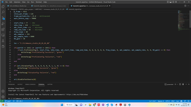

    I read the Lua script, and it appears that two RX are being employed. The scripts are included for your convenience. However, I could not comprehend the significance of the other lane configuration parameters. But I could not run the MATLAB script. It shows that It would make it easier for me to run the MATLAB  code.Please suggest a way to fix it.

    I checked the lua script and it looks correct.

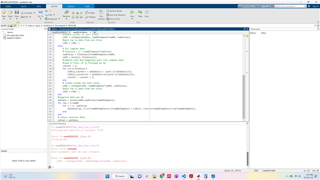

    I think the error comes from numChirps computation.
    Can you please compute manually
    numChirps = fileSize/2/numADCSamples/numRx
    I don't think this will be an integer, that's why the reshape function has an error.
    Due to the long recording time (~ 2 hrs) I think it is possible that some samples are dropped
