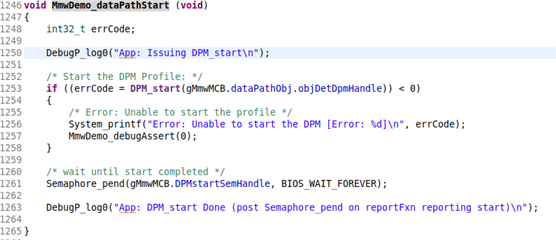

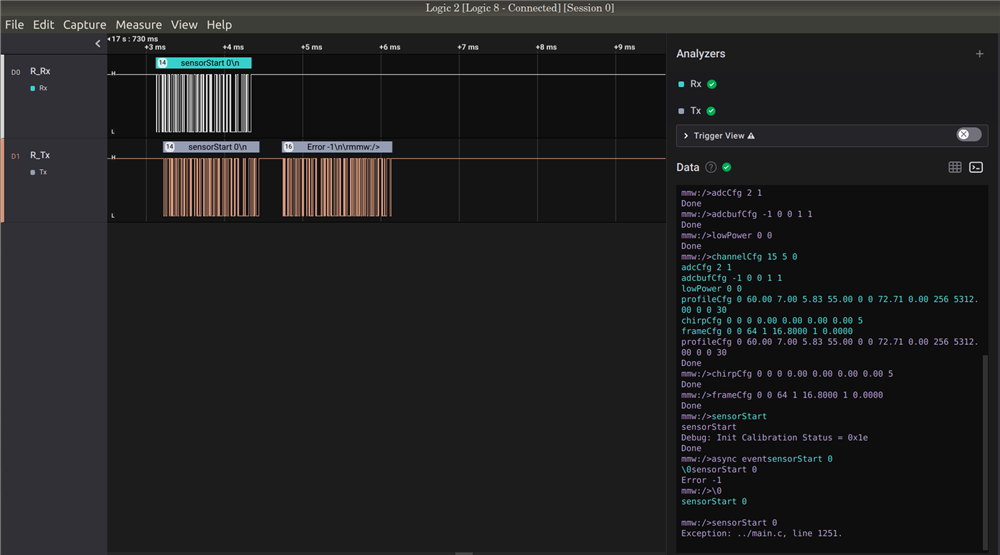

  • Hi Josh,
    Thank you very much for your suggestion, it was really helpful in debugging the issue.
    We tried it by changing the state inside the async call-back function.
    However, when the next start command "sensor start 0" is issued, it fails on the MwDemo_dataPathStart function(Invoked from MwDemo_startSensor Function).
    Code Change: State Changes from sensor start to sensor stop inside the MmwDemo_eventCallbackFxn in main.c
    Command and ACK from radar in the logic analyzer for the second radar trigger ("sensorStart 0")
    Exception Throws:
    Could you please assist us in debugging and resolving this issue?

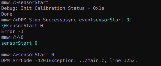

  • Hi Josh,
    We tried to debug further by printing the error number in DPM_Start  and attached the image for reference.
    The error code received from the radar is -4201 and its corresponding error message is "MMWAVE_ERRNO_DPM_BASE - DPM_EINVAL(Invalid Argument)"
    Whether the invalid argument pointing to the DPM handle or anything else?
    Could you assist us in debugging this issue?
    Balaji

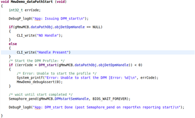

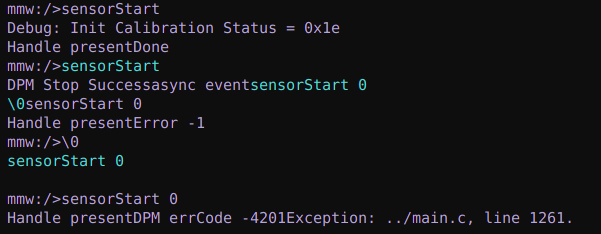

  • Hi Josh,
    We tested further.
    It is failing inside the DPM_start, thus there are two possibilities for failure.
        1. Handle issue (NULL)
        2.  Profile is an invalid state (ptrDPM->procChainStatus & DPM_PROC_CHAIN_STATUS_STARTED)
    We tested by checking the handle whether NULL or not, inside the MwDemo_dataPathStart function.
    However, the handle is not NULL. Then the issue is due to the second scenario.
    Could you please help us in debugging and resolve the issue?
  • Hi Balaji,
    Are you still facing this issue? I suspect that when the configured number of frames is reached then DPM_stop() is not called like it is when sending sensorStop. This means that the value for ptrDPM->procChainStatus is never updated and thus DPM_start() fails.
    Josh

  • Hi Josh,
    I'm still dealing with the same issue.
    Error: DPM errorCode -4201
    Warm Regards,
    Balaji Sridhar
