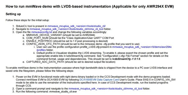

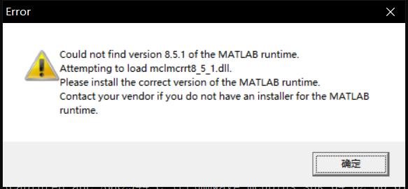

I collected data according to the method above. In the case that Matlab Runtime 8.5.1 was installed, the following error would appear.
Could you please tell me what might be the cause? And how could I solve this problem?
