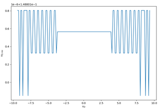

I am trying to understand the relation between the chirp parameters and the high level parameters such as v_res, v_max etc with your Programming Chirp Parameters Guide. And since I need to measure the Doppler velocity as accurate as possible, I noticed that the velocity resolution is being rounded up in the demo visualizer. This can be seen in the comments of the auto-generated config files. And in the radar output I noticed a smaller v_res, that is oscillating ones the velocity is above a certain value.
For example:
calculating v_res with the following formula
and the parameters: lambda = c0/f, f = 60e9, N = 384 and T_c = 4.3e-05, while T_c is T_c = T_idle + T_ramp_end.
I get approximately v_res = 0.1513 m/s and v_max = 9.683 m/s,
while in the auto-generated config file from demo-visualizer it is v_res = 0.16 and v_max = 10.24.
Radar output (with Out of box demo):
In the radar data I observe a variable v_step size, different from the v_res config file and the calculated value. I measure values like these: 0.1488018035888672, 0.14880084991455078, 0.14880132675170898, 0.14880156517028809 [m/s]
And a maximum v_max = 9.37449836730957 m/s
I found that the v_res is oscillating ones the velocity reaches > 3.8 m/s
If I use  f=62 GHz for the above calculation I get v_res = 0.1464 m/s and v_max = 9.3709, which is closer to the measured v_res.
But why is it oscillating? And how is the v_res being exactly calculated?
I know that lambda is varying due to the frequency sweep, could that be the reason? If yes, how did you decide the frequency / lambda.
Or is this oscillation a machine precision error?
Raschid
  • Hi Raschid,
    Velocity resolution should be computed as the equation you have listed describes. You should use the center frequency for your calculations (62 GHz not 60 GHz). But how did you generate that plot of velocity vs velocity resolution? Is the x-axis supposed to be maximum velocity? And the velocity resolution you list in text of 0.1464 m/s does not align with any of the y-axis values.
    Nate
