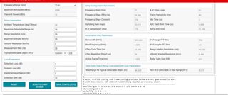

I'm using the AWR1843 radar with the OOB demo and I'm trying to detect an object in a range of 35m/50m/70m maximum.

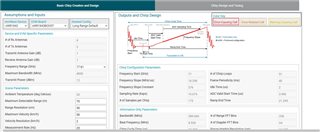

I used the Mmwave Sensing Estimator tools and I obtained a cfg profile of maximum detectable range = 70m with a typical detectable object Custom = 0.5.
When I tested with this config cfg with an object in front of the radar with a range =35m I had no points detected.

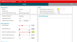

and when I used mmwave Demo Visualizer to get a profile cfg with range max =50m and RCS= 0.5 or =0.1 I start getting points detected.
I want to know why, with the cfg file of mmwave Demo Visualizer, I start to get points and with the other file I get none. ???
Ps : you will find here the 2 files cfg of configuration and the captures of the parameters set up:
- Captures Below For MMwave Sensing Estimator

- Captures below for mmwave Demo Visualizer :
 profile_mmWave_Demo_Visualizer_R50.cfg
