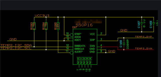

mu customer use TMP400 to read CPU temp in OTN(optical transmission network), but we find that TMP400 will jump between 33 to 40C suddenly and recover in 1 mins.
could you help to review the schematic and give some advice in this application? thanks.
BR
Chi
  • Hi Chi,
    The schematic is fine. Customers often report noise problems with remote temperature measurements. It is necessary to provide EMI shielding for the DX traces.

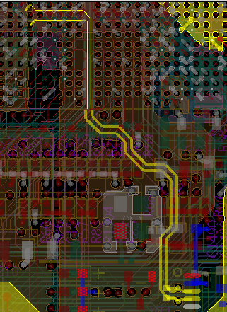

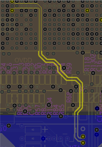

  • Hi Ren,
    thanks for your reply, here is the PCB for DX trace.
    it is not very easy to measure current, so we test the voltage difference between DX and DP
    please help to review, and if it is possible, could you also help to explain why only 33C to 40C has jump issue when noise show up.
    BR
    Chi

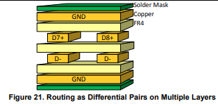

  • The layout is dense. I can't draw any other conclusion from this picture. Ideally, the DX traces should have GND planes on both sides to block EMI. I can't tell what is around the traces. Here is artwork from the TMP400 datasheet:
    Here is similar artwork in the app note SBOA173:

  • Hi Ren,
    customer use GND and power layer on both side DX trace.
    also, for the picture, showing voltage between DX and DP, my understanding is DX and DP is side of PNP or NPN, so they should have linear voltage difference with temp. why we have seen this wave if it is not affected by noise? sorry I didn't get your point in your last explanation.

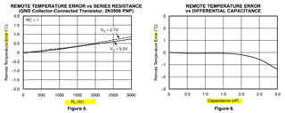

  • Yes, the best way to prevent noise is with shielding. You can also increase filtering of Rs and Cdiff shown in Figure 11.
    When increasing these values, please observe Figure 5 and Figure 6. Note that Series Resistance of the two Rs shown is summed.
    It's my anecdotal opinion that it is very difficult to fix noise problems with filtering alone, but the filters are popular.
