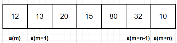

I have a question regarding setting up the threshold value in "Impulsive noise removal" and "motion corrupted segment removal/Gain control."
  • What threshold values and interpolated values have TI taken for the development of the vital signs lab?
  • What user-defined threshold value has been taken by TI vital signs lab development team?
Apart from this question, I have other questions.
  • What is the m and a(m) indicated in impulsive noise removal?
  • is it a bin in the slow time axis >>>

  • Hi Deepu,
    You can look at line 608 for impulse noise removal and then look more specifically at the filter_RemoveImpulseNoise function which is called on line 615.
    The variables for detecting motion corrupted segments can be found at 424 so I would trace where these are used.
