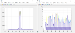

2) They also tried the data injection test, only the first Doppler unit of the 10th distance gate was injected, the other full assignment was 0, and the injected test data was a sinusoidal signal as follows:
The figure on the left shows the data exported by dopplersubmat (processed with matlab), and the figure on the right shows the data exported by AzimuthScratchBuf after 3DFFT, which is also 0 on the other range units. There are no peaks, which are consistent with the results of the matlab simulation.

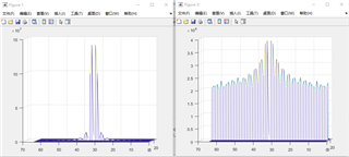

    The result after modifying the HWA_RAM_type_VECTORMULTIPLY_RAM is shown in the following figure:
    But the side lobe of the 2944 is a little high. Are the above results correct?

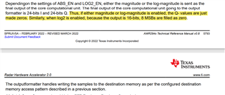

    The customer does not have the configuration window function and should output after the FFT after ABS and log2 have been completed.
    According to the TRM, the output should be 16 bits of data, with the upper 8 bits being 0 and the lower 8 bits being the output data.
    But the actual data read out is typically not 0 in the upper 8 bits. Why?

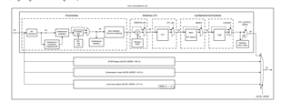

    The processing block diagram is shown in the second figure (from the TRM).

    In your latest reply, the sidelobes seem to be a result of not applying windowing for your input samples. Can you confirm if the effect is minimized with the application of windows?
    Also, have the confirmed the output of FFT ABS?

    4. After inverting the output 3DFFT result according to the output formatter in 2944TRM, it can be the same as the 3DFFT done by matlab with the 2DFFT result.

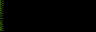

    Finally, a bitmask on rangeBin is output using the serial interface, as shown in the following figure, the upper two bytes of each UINT32_t are all zeros:
     for(local_max_pri=0;local_max_pri<64;local_max_pri+=2)
                CLI_write("%x %x\r\n",*(result->local_bitmax+result->objOut[energy_max_index].rangeBin*64+local_max_pri),*(result->local_bitmax+result->objOut[energy_max_index].rangeBin*64+local_max_pri+1));
    Does the bitmask reside in memory in the following order:
    DopplerBin0[ant0,ant1...ant63],dopplerBin1[ant0,ant1 ... Ant63],..., dopplerBin31

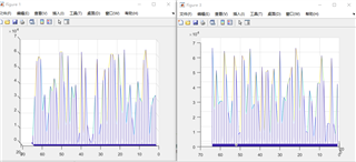

    5. The following figure shows the angle unit of the maximum energy target detected and the energy value of the adjacent angle channel, where ANT sub represents the angle channel where the peak is detected minus one and ANT add represents the angle channel detected plus one.
    As shown in the figure, peaks were detected on the 63 th angle channel, +1 was the 0 th channel, and -1 was the 62 th channel. The corresponding output can also be found in the above file. Where the value on channel 0 is greater than the value of channel 63 where the peak is currently detected.
    6. The following figure shows all targets detected on rangeBin and dopplerBin where the most energy targets are located (in OS-cfar, all angular channels on this rangeBin and dopplerBin are detected):
    7. The following figure shows the bitmask on this rangeBin detected by local maximum, where a row represents the results of peak detection on a dopplerBin corresponding to the Doppler channels of [31,0], [63,32], respectively.
    The first line represents the 0 dopplerBin, which is 4882120 82304022, where 4882120 represents the channel peak detection result of [31,0's], expressed in hexadecimal and convert it to binary.
    It can be seen that the targets in the figure above are all detected in the graph, but the angle channel 0, which is the maximum value on the current dopplerBin, is not detected as a peak (other detected peaks, while detected in OS-cfar, are beyond the set angle range. So it's filtered out when it's added to the target list.)
    Why does the local maximum detection feature of the hardware accelerator not detect the highest peak? Currently, both lateral and longitudinal threshold detection for local maximum is turned off, setting the LM_thresh_BITMASK to 11b.
