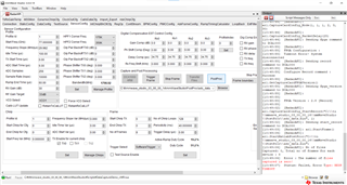

I'm using mmWave Studio3.0.0.14(AWR2243 and DCA1000EVM), but I can't find the file for "adc_data.bin".
Please help me to resolve this issue.

Hello Ryuta,
You care unable to find the file because the file is not being generated, and that is because the DCA is unable to capture the frames.
It says in the debug log that the Captured - 0, which signifies either the setting or the process is wrong.
Just to confirm have you followed the steps in the user guide to initialize and then connect to the DCA before triggering the frames?
Also, could you confirm if the AWR2243 EVM and the DCA1000 EVM are physically connected using the 60-pin ribbon connector?
