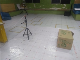

We used a Pole as an Obstacle and there are few questions we needed to ask:-
1)How to improve the Accuracy of Cluster coordinates. We were getting a error margin of 10-15cm esp when obstacle is closer to radar(0-40cm)
2)We want to find out the dimension of the Obstacle. Can a cluster size give us the dimension of the Obstacle. If yes, How accurate is it? (please refer attached data below)
    No, the cluster size is related to the detected points it does not allow to give the dimensions of the obstacle. With a radar sensor it will be very difficult to determine the size of the object because there is not sufficient angular resolution. There are no sufficient detected points to determine the size of the object.

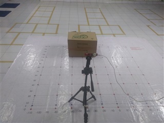

    For the Carboard box mentioned above,we are attaching the GUI Screenshot.We were expecting the radar to detect multiple points along with edges of box but to the contrary radar is detecting the center of the box.Can you explain exactly why this behavior and could suggest ways to make the radar detect multiple points
    (Pls note:Radar height:82.5cm and Box Height is 40cm above ground.)

  • For the Carboard box mentioned above,we are attaching the GUI Screenshot.We were expecting the radar to detect multiple points along with edges of box but to the contrary radar is detecting the center of the box.Can you explain exactly why this behavior and could suggest ways to make the radar detect multiple points
    Due to the angular resolution of the antenna which is around 30 deg, it will be challenging to detect multiple points. This is the reason why you are only seeing the strongest reflection in the center of the box.
    If two static objects are in the same range bin, than they will not be detected separately if the angle between the objects is smaller than the angular resolution.
