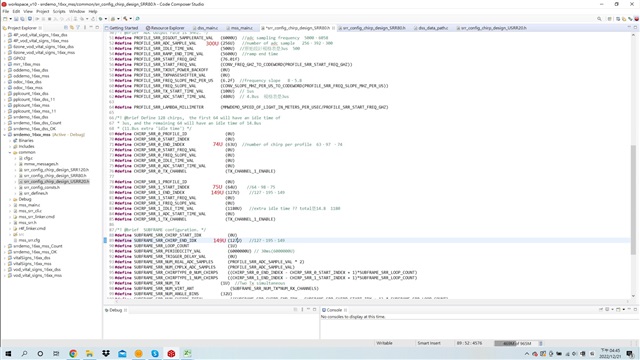

Customer changed ADC_SAMPLE_VAL from 256 to 300, but there is nothing shown on the UI. Is there something he missed?

    When you made the changes, were the changes applied to both the mss and dss project cfg header file?
    Yes, the modification is made in srr_config_chirp_design_SRR80.h.

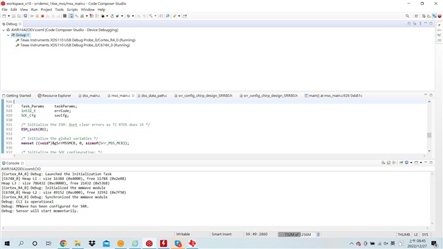

    • Can you confirm this is the same error you see in CCS when you try running the code with the changes?
    Error: mmWave Config failed [Error code: -3108 Subsystem: 41]
    After modifying the parameters and running the code, there is no error message as below snapshot shown.  But the GUI can't detect the object. (Please be noted that SAMPLERATE_VAL is set to 6,000, frequency slope is set to 5.8, when SAMPLERATE_VAL is set to 5000, it prompted the error. )

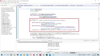

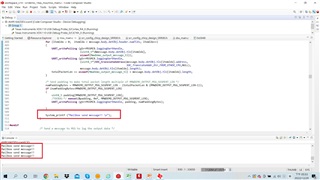

  • Hi Kaushik:
      I added the printf command in mboxReadTask, the mailbox is in operation。
    Thanks for your input. It looks like the pipeline is running as expected from your screenshot. Can you confirm if there is data coming out on the UART data port?

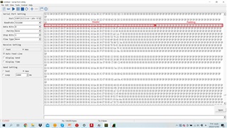

      The picture below is the data received from UART, there seems to be a problem with the data in the TLVs . but I don't know how to solve
  • Hi Nicky,
    You can try to run the srr_ti_design_visualization.m with breakpoints and observe whether the right data has been received from the board (Check data once it has been read and parsed based on TLVs). This can confirm that the application on the board is not at fault and there could be something to do with the GUI.
    Kaushik
  • Hi
    In the current state of data export, it looks like DSS does not export TLVs data. So the data output from uart only has header and padding.

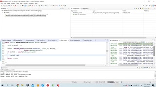

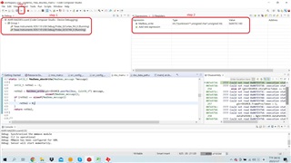

  • Hi:
      I'm trying to figure out where the datapath is going, but I seem to have issues with the use of breakpoints.
  • Hi Nicky,
    Can you let me know what steps you are taking to debug the same?
    As mentioned earlier, it would be simple to run the code for a single frame (refer frameCfg) and step through the code by placing breakpoints.
    Kaushik
      1.In debug mode, finish loading the program
      2.Add new expression (Mailbox_write)
      3.Run Program
      Is my process correct?
