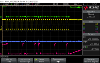

    Attached here you can find a capture of the signal CS, CLk, MOSI and MISO from top to bottom

        Thank you for sharing the SDK version and Oscilloscope waveform, Could you please explain what you were trying to do and where is the anomaly?
    Is the SPI is connected any secondary device? What address you are trying to write/read? How is the hardware connection?
    Standalone IWR6843ISK doesn't use SPI interface, Hence could you please explain your setup?

    I work with the IWR6843ISK on the MMWAVEICBOOST board. The ISK works as spi master and trying to read 3 register sequential from address 0 to 2. Each register has 1 Byte information. With this sequential access I receive more data faster.
    So the communication (byte to byte) should run like:
    MOSI: Address - D1 - D2 - D3 (0x00 0x00 0x00 0x00)
    MISO: Status    - D1 - D2 - D3 (0xSS 0xd0 0xd1 0xd2)
    The situation is the slave device understands the peak in CS as a new communication start. It thinks:
    MOSI: Address - D1 - Address- D1 (0x00 0x00 0x00 0x00)
    And it answers:
    MISO: Status  - D1 - Status – D1 (0x80 0x82 0x80 0x82)

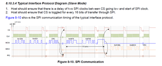

    The devices SPI IP uses a MibSPI Protocol by TI.
    For the SPI operation CS signal must be toggled for every 16 clocks or programmed data size, could you please check the compatibility with the peripheral connecting to the SPI port?

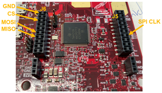

    The frequency I've tried is 4MHZ. The quality of the signal above this frequency is not very high (I think with a pcb from us will be better, because I work with three eval boards)
    Attached the interface in MMWAVEICBOOST using for the SPI:
    Thanks!

    Yes, three boards stackup adds larger parasitic on the SPI lines, Hence it may not be operational at higher frequency. You could try even lower frequency if there are long cables from the MMWAVEICBOOST board to SPI peripheral.
    For keeping CS line active low, you may want to use CSHOLD Bit as described in the Technical reference manual shown below, it may help to overcome this problem.

       Using CSHOLD with CHARLEN = 0x8 should get the desired result.

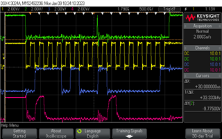

    With dataSize = 8U I got the peak after 1 byte und that reset the spi communication
