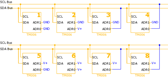

Hello Tomoaki,
I apologize - Table 1 in the TMP006 data sheet which shows the address combinations is incorrect. We are in the process of revising the data sheet, and the new version should be ready by the end of this month.
The table below shows the proper connections for all 8 address combinations.
Ian Williams
Linear Applications Engineer
High Performance Linear
| A1 | A0 | Address |
| 0 | 0 | 1000000 |
| 0 | 1 | 1000001 |
| 0 | SDA | 1000010 |
| 0 | SCL | 1000011 |
| 1 | 0 | 1000100 |
| 1 | 1 | 1000101 |
| 1 | SDA | 1000110 |
| 1 | SCL | 1000111 |
Hi Ian,
Thanks! So it means that we can make the connections as below?
Tomoaki Kobayashi
Hello Tomoaki,
Yes, those connections are correct.
