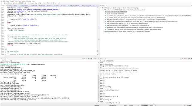

Hi Alec,
Thanks for the suggestion.
we created the timer interrupt as per the TI-RTOS user guide.
However, after creating the timer interrupt, we are having issues with object detection.c
Attached is the image for your reference.
Without a timer, we are not facing this issue.
Could you assist us in identifying the cause of the issue and finding a solution?
Modification:
Error:

Hi Alec
It keeps failing in the same place.
By including the CLI write log statement inside the service routine, we were able to confirm that the functionality of the timer interrupt was working.
However, if you give the "sensorStart" command, it fails with the same problem.
We are unable to determine why creating a timer causing this error.
I've attached the image for your reference.

Hi Alec,
This issue was resolved by initializing the timer after the MmwDemo_DPC_ObjectDetection_dpmTask task creation.
However, the run time error occurs when the MmwDemo_stopSensor API is invoked inside the service routine.
Please find the attached image for your reference.
If we follow the call-back table as per the attached image, it was failing inside the rlDriverCmdInvoke function in rl_driver.c
Could you kindly assist us in troubleshooting and resolving this problem?
Warm Regards,
Balaji Sridhar
Glad to hear you were able to resolve the initial issue. In regards to the stop sensor call, I would warn against calling this function from the ISR, as you may be spending too much time in this function, and not servicing some of the other tasks or interrupts needed to properly stop the sensor. I expect that if you call the stopSensor from a different context (by posting a semaphore in the ISR) you will likely resolve your issue.
Alec
