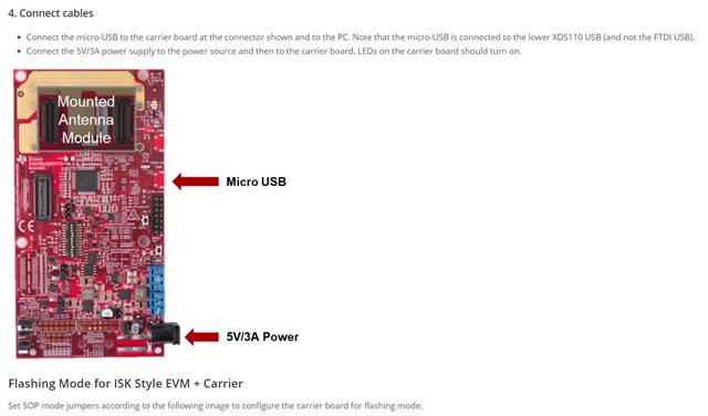

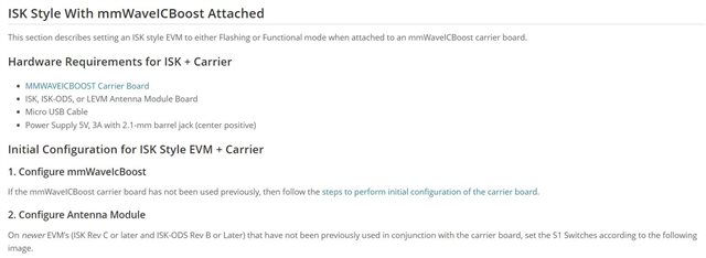

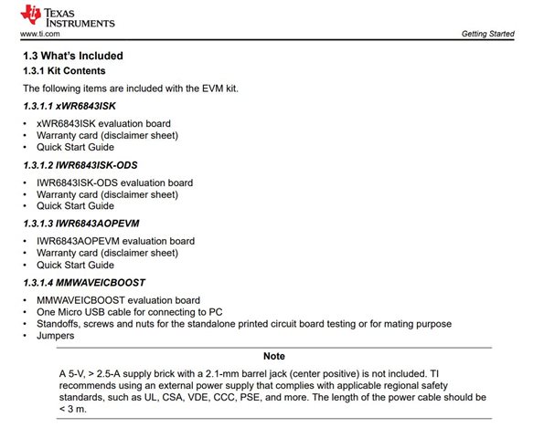

My misunderstanding stems from the fact that I cannot find any mention in the user guide regarding as to how one is supposed to connect the AWR6843ISK REV D to the MMwaveICboost board:
This is how I have connected the board (photo below), I would like to make sure that it is correct in order to prevent any potential frying of components.
Can anyone here share with me some advice in the matter?
Which Part in the MMwaveICboost user guide will be the best reference as to regarding to how should I continue the integration between the components?
