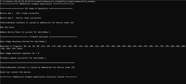

I have AWR2243Boost connected to DCA1000 trying to run this radar through mmWave DFP User Guide. I try to follow the steps in the guide by running mmwavelink_example.exe in the command prompt after going to the mmWaveLink_SingleChirp_Example directory. However, I am not able to get the expected output as shown in the demonstration. I get the following:
I appreciate you if you could help me find my mistake

  • Hi Kia,
    Have you changed anything in the mmwaveconfig.txt file? If not, can you once try this setup with the mmWave studio and share your log results with us. I see one MSS CPU fault being raised in the screen shot you provided, and we will need to debug this further to get to the cause of this issue.
    Pradipta.

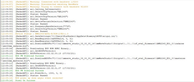

  • Hi Pradipta,
    I had changed the mmwaveconfig.txt file, and I thought maybe that would be the cause but I tried the original version and still got the same error. I am able to run it with the mmWave Studio with no problem. For mmWave Studio, I put the SOP1 pin back to 1. In mmWave Studio, I use a different lua script with different settings. Here are the messages:
