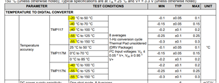

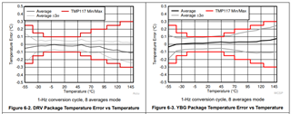

I had a question about the temp accuracy for TMP117M.  Do you have any data for us to understand what the temperature accuracy looks like below 0c?  Is it like a step function where the error can be significantly off?  Or it’s just not measured so you can’t guarantee a spec?  We are trying to determine whether we can consider this part as viable for our application.
Adam
