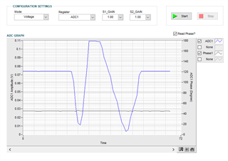

I am trying to use a PGA970 evaluation board with a 4-wire RVDT sensor and I am unable to see a change in the phase angle when looking at the ADC capture from the provided GUI. Based on what I am seeing I assume that I have not correctly configured the device but I am unable to find any information in the data sheet that would lead me to the answer.  I have also searched the TI forums and found this post which seems to have the exact same problem but unfortunately there is no posted solution.
I have attached a screen capture of the ADC and Phase plot from the GUI as well as my current configuration that I have saved off in case they are useful in helping me to troubleshoot this issue.

    I was hoping to solve the issue before responding but the short of it is I can't replicate the issue in the lab. The GUI seems to track phase correctly for me.
    This is led me on a bit of a rabbit hole to see how the phase is actually displayed in the GUI. My current thought is that it looks like the GUI uses PHxDATA[0:31] from demodulation. And the data looks good from the ADC and correlates pretty well. There really isn't much info phase extraction so I can't make a comment how it might be causing an issue.
    I will say I don't have RVDT in the lab and I really just use a sine generator. I would recommend trying that lab to see if the issue persists. That being said, we've sold a lot of PGA970s and know of customer who use the phase so I don't see an obvious reason why a RVDT would cause an issue.

    Is there any configuration that I would need to make on the GUI in order to enable phase angle output?  Would it be possible for you to post your register configuration here so that I can compare it to what I am using?
    Nick
