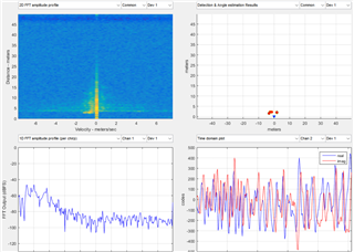

DCA1000EVM: I want to create a 2d fft image through the captured raw data.
Part Number: DCA1000EVM
Other Parts Discussed in Thread: IWR6843ISK-ODS
Hi TI Customer Support,
I am a beginner student studying radar. So please escuse me if the question is a bit stupid.
I am using IWR6843ISK-ODS with DCA1000EVM capture board. I have a question.
First, I was able to check the corresponding result through the mmwave studio.
For machine learning, I intend to produce the above "2d fft image" through MATLAB.
This is to be solved by accessing raw data by referring to the document swra581b (9.2).
Therefore, I modified the MATLAB Example as follows.
% return receiver data
retVal = adcData(1:4, 1:32768);
fft_out = fft2(retVal);
fft_out = abs(fftshift(fft_out));
fft_out = 20*log10(fft_out);
ADC Bits 16, complex1x, ADC sample 256, No of chirp Loops: 128, No of frame 8
I followed the above specifications, so 32768(ADC sample(256) x No. of chirp(128)) data in one frame.
But I can't see the same image in MATLAB as I saw in mmwave studio.
What is wrong?

    The adcData will need to be reshaped per chirp and per number of antennas. An example of using the reshape function can be seen in the 9.2 example already. This function will need to be used to organize the ADC samples by antenna and by chirp.
    I would recommend doing the fft in two steps, first do an fft per chirp / per antenna and then perform the second fft.

    Please keep in mind that the coloring in matlab may not be exactly the same as the coloring in studio. This looks like it may be correct but with both axes flipped.  Below is a code snippet that may help explain what I mean by "I would recommend doing the fft in two steps, first do an fft per chirp / per antenna and then perform the second fft"

  • I flipped the axis, but it's still different from what I saw in mmwavestudio. (Right one is an image from mmwavestudio.)
    How can you make this the same as the picture above?

  • Thank you for your sincere response. In the .m file you uploaded, variables such as the number of chirp and the number of frames were adjusted according to the situation. But I still can't see the result I want. In mmwave studio, I can see that the axis is speed and distance, but is this not relevant?
